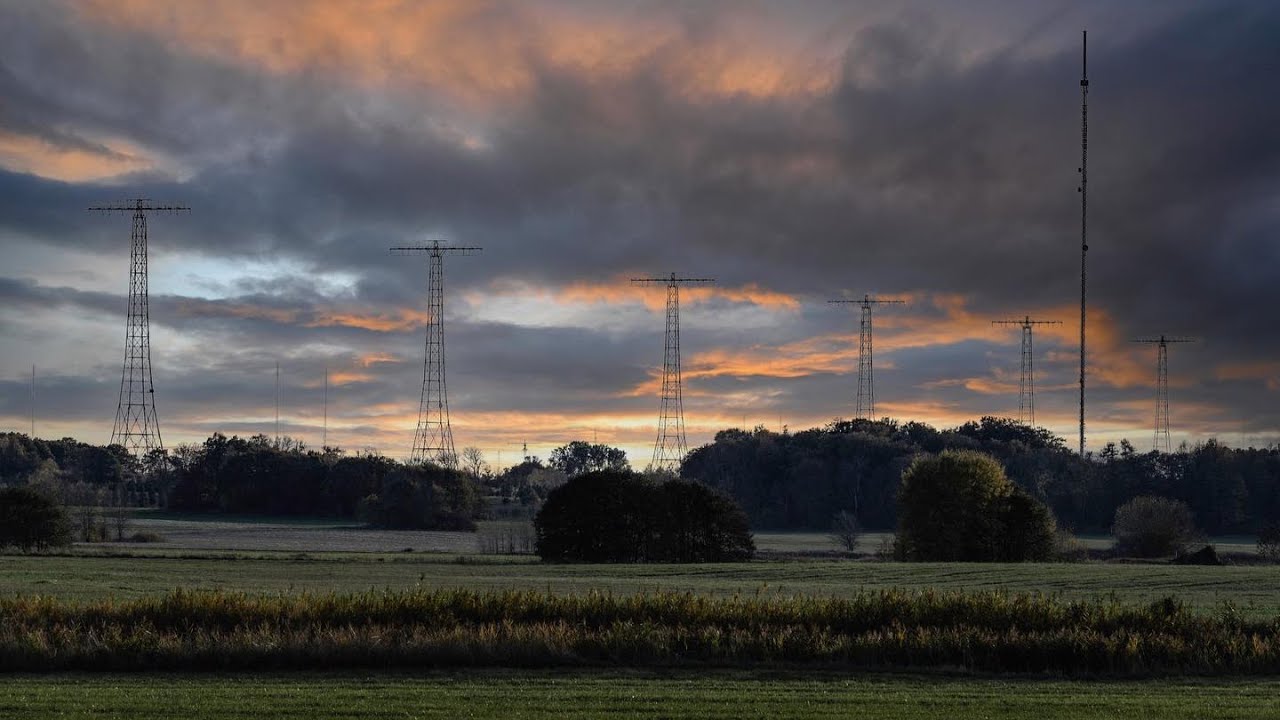

    Live video from SAQ Grimeton - UNESCO 50th anniversary, Nov 16th 2022
    16:25 CEST (15:25 UTC): Live video from World Heritage Grimeton Radio Station begins16:30 CEST (15:30 UTC): Startup of the Alexanderson Alternator SAQ from 1...
    www.youtube.com
