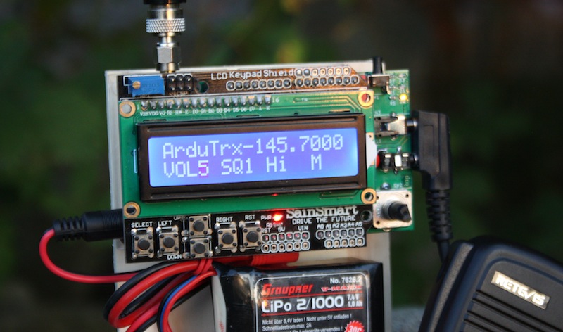

    VHF bzw. UHF Funkgerät zum Selbstbau
    Bernhard Mayer hat uns auf sein interessantes Selbstbauprojekt hingewiesen, ein FM Funkgerät für VHF oder UHF, das mittels eines Arduino und der entsprechenden…
    www.hamspirit.de

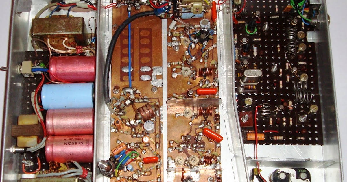

    A homebrew 2m FM rig
    Amateur Radio - VU2NAN - Nandu. Homebrew antennas, receivers, transmitters, test equipment, concepts, circuits, photos, operation and troubleshooting.
    nandustips.blogspot.com

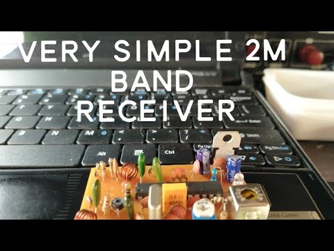

    TRX FM 2m simple
    dra818simples

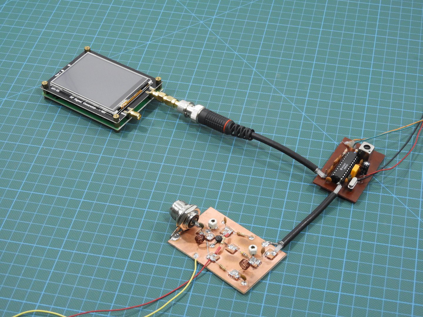

    A two transistor super-regen VHF receiver
    Trying out a new super-regenerative VHF receiver inspired by a similar set built by Alan VK2ZAY and demonstrated on his YouTube channel (Advent Project 18). ...

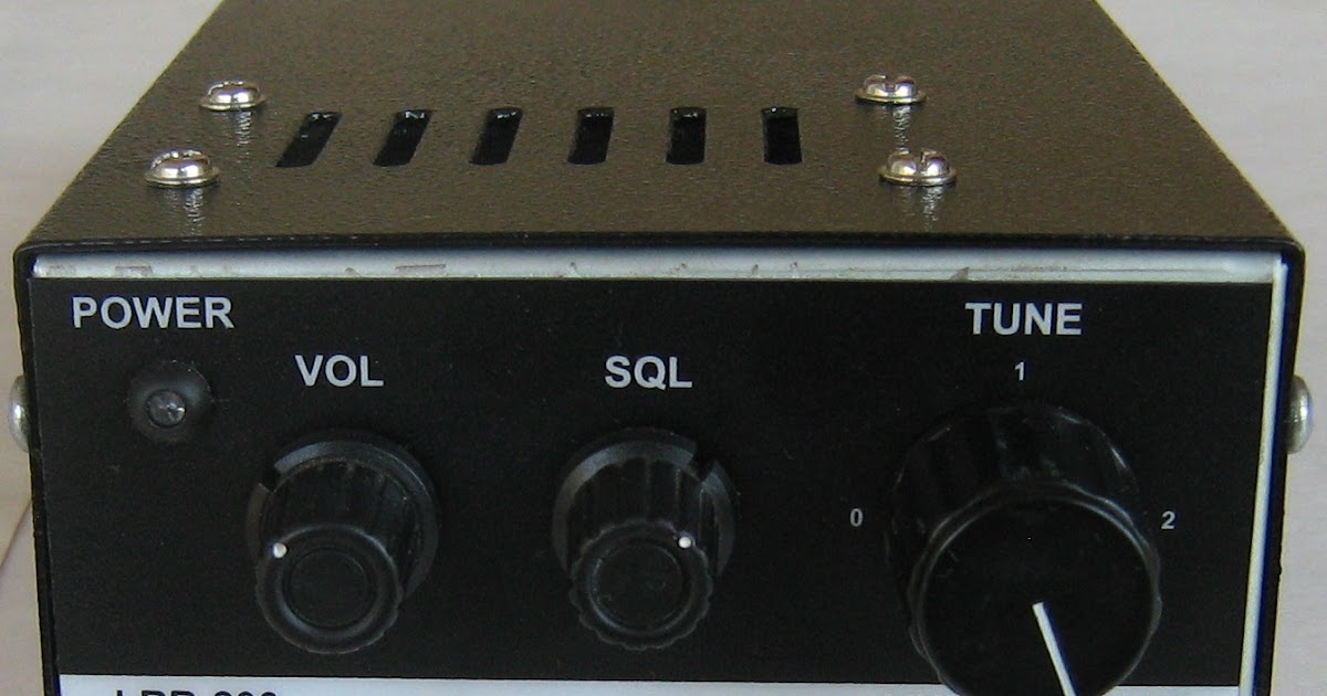

    LRR200 2Meter FM Receiver
    " A blog about Ham Home brew "
    homebrewcorner.blogspot.com

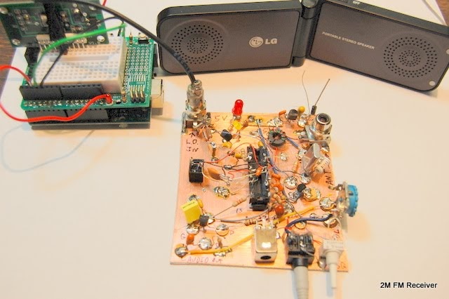

    2-meter FM receiver with MC3362 chip and Si570 synthesizer
    I discussed the Si570 and controlling it with my Arduino in an earlier post.  The fact that it can reach 160 MHz made me think of using it ...
    wa5bdu.blogspot.com
